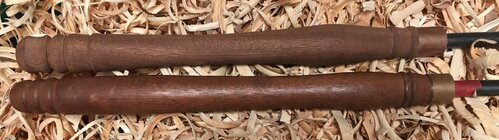

These are sapele cut off handles for my two Jamieson bowl gouges.

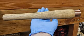

I've chosen the lovely billet of white oak to provide me with the 3 new handles. I turned one down to a rough cylinder this evening, but then got distracted, by necessity, by making copper ferrules.

Here is one of three, two are complete. White oak with a quick smear of T&T Varnish Oil after a brief hit of 120 grit, otherwise I did not want glassy smooth. A shade over 14" long, ideal for my forearm length when riding my forearm on top the handle, it stops before it gets to the funnybone patches in my elbow. Fattest area is about 1-9/16", skinniest about 1-1/4". Then up in the hump I touched the wood repeatedly with the tip of a 3/8" spindle gouge, providing a good friction, yet low strength, grasp on the handle. I played with all the tools in my collection and payed attention to what I liked and... liked a bit less. This should provide me a relaxed grip so I can steer the tool without much grip effort, and be a good counterbalance to the 3/8" thick steel that will be mounted into it.
Nice handle, Steve. I like the spindle gouge texturing as well.
