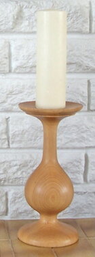

I also drilled a recess and held the Candle holder with tailstock help and then turned and finished.
