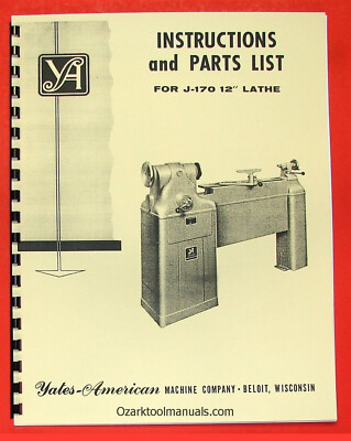

I think the best way to move it depends on the weight, how it's built, how much of it comes apart easily, and how many strong people you have. AND the terrain and access at both the pickup and destination places.
Laying an assembled lathe down for transportation might depend on how it's made. Shouldn't hurt it but may need wood blocking to protect any protruding levers or controls. If the Yates is like this it might be hard to disassemble:
I don't know anything about the two lathes you mentioned - I hope you were able to inspect and see them run first. I've seen some old lathes that were so abused and worn out they not useful without a lot of work. Maybe you will be fortunate! A lathe larger than what you have now could be a big help.

You hit the nail on the head with what lathe it is. The location has a loading dock but I was going to use a friend's truck and dump trailer to pick them up. The dump trailer bed is about 24"s off the ground and a loading dock is at 4 feet or slightly higher. My options are to run a motorcycle loading ramp from the loading dock down to the trailer or see if I can get the lathe on ground level and basically back them up to the trailer and tip them over backwards onto furniture dollies on the trailer bed.
I took a chance on equipment that was "working when removed from service" according to the listing because they were cheap. Might be time to stop being cheap and pony up the cash to rent a box truck to make loading easier.
