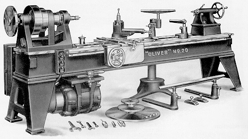

This is an Oliver patternmaker's lathe:
http://www.olivermachinery.com/ReferencePhotos/MachinePics/20.jpg
Check out the reference photos on this page for the real deal:
http://www.olivermachinery.com/welcome.html
I wonder how many of these beauties have been melted.
My dream lathe remains the Oliver Patternmakers 21 or 22 such as this gorgeous piece of iron:
http://www.owwm.com/photoindex/images/585-A.jpg
They used to make some of (if not THE) finest woodlathes in the world. Of course, you have to have a 6" thick concrete slab to use some ;)
