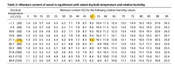

When air drying wood the first step is find the humidity and temperature of your drying area.
My drying room has a dehumidifier suet at 50% and average temp of 70+
My bowls will dry to 9.2 to 9.1 percent MC when they reach equilibrium. They never get any dryer.
