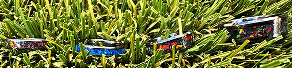

Here are some pics of a few of the rings. Still working on photographing them well. Reflections from the lights and other things make the ceramic look like it has finish flaws. Basically they are ceramic (or metal) ring blanks that are filled with synthetic opal chips and mica powder filler, all secured with CA glue. Then sanded down to be flush with the blank then final CA finish, sanding and polishing.

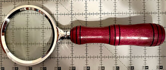

Here's my first woodturning project, from a Rockler class with carbide tools. Wood is purple heart, finished with Mylands High Friction polish, Rockler magnifying glass kit.

Those are fancy! And a good start on the turning! Is that magnifier shaft threaded? Where did you find the hardware?

Yes the shaft is threaded. As stated, the hardware kit is from Rockler. https://www.rockler.com/rockler-magnifying-glass-turning-hardware-kit Comes with the glass and a threaded insert. After drilling and installing the insert, they have a mandrel that goes into a chuck on the lathe and the handle screws onto the mandrel. You have to buy the mandrel separate from the kit.
