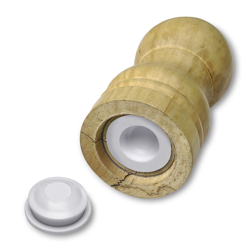

There is also a plastic bung for salt shakers.
Specifications:
Dimensions: 1-3/16" dia. x 1/2" thick
