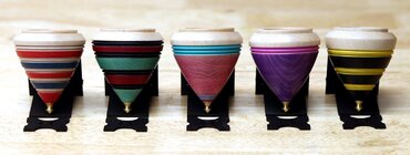

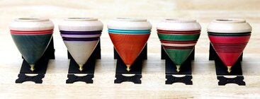

I think it depend on whether you put any finish on top of the ink. Most of the time, I put sanding sealer on the piece after inking and then 3-step Beall buff. No fading issues that I've seen so far.Top_2024_44_48a.jpg
