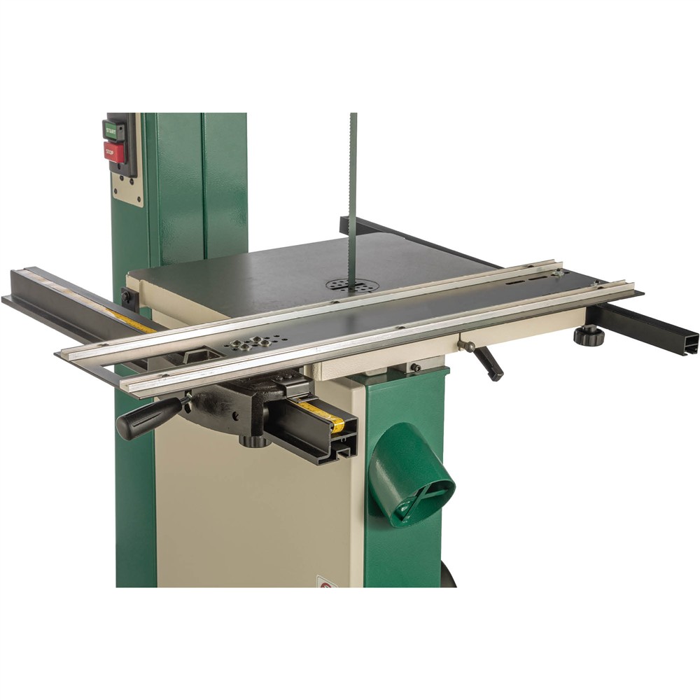

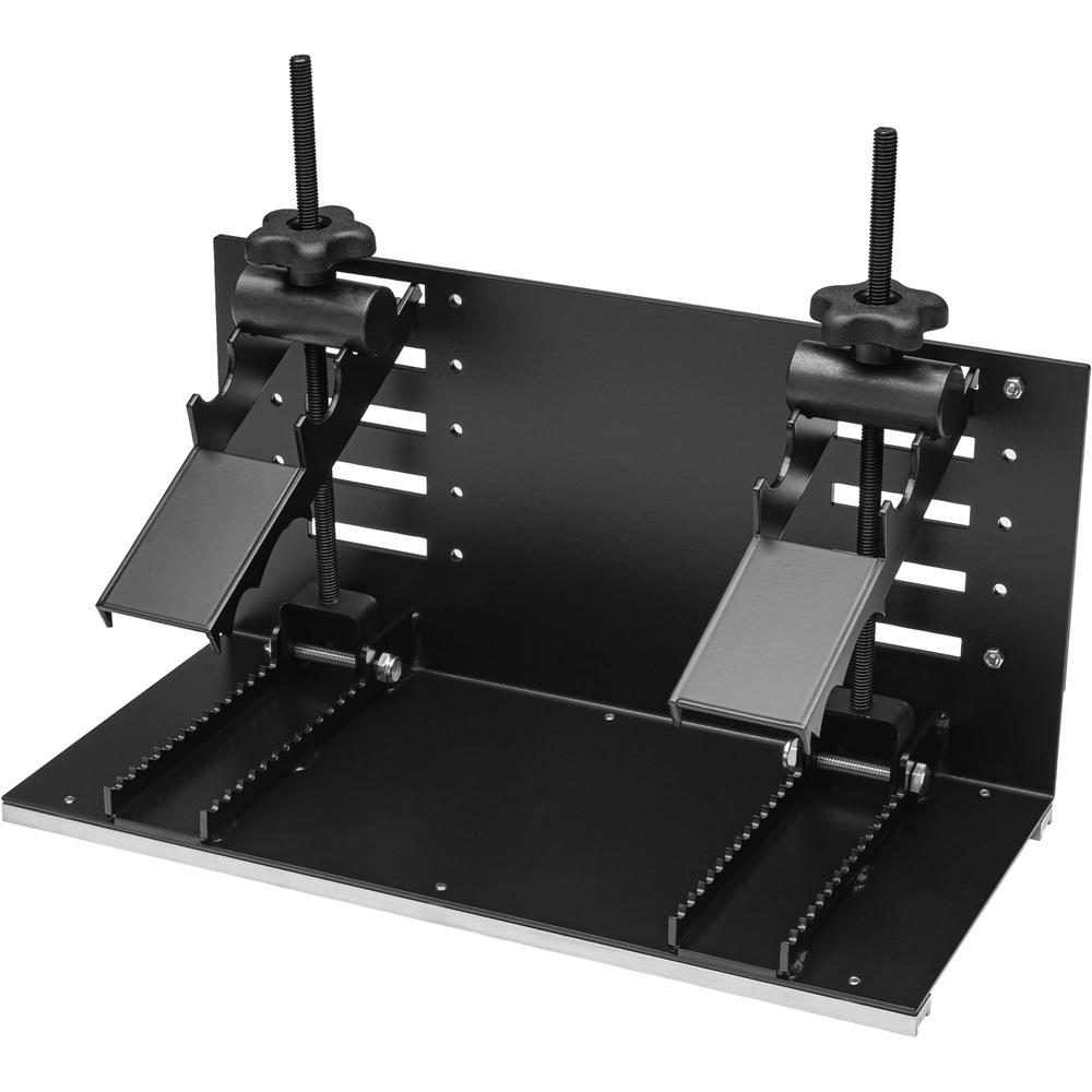

If anyone has used either of these, I would love to hear your experience with it. If anyone has the Grizzly setup, Could you give me an idea of how big it goes, and what is the length of the rails that attach to the bandsaw, and how long is the piece the log sled slides on?
I'm getting frustrated with the small size of the table on my bandsaw. I have a 1990's 14" Delta with riser and 2hp motor. I was considering moving up to new saw, but I'm seeing that the tables on anything under ~$3k are not much bigger than what I have. An inch or two at most. in addition, they mostly come with roller guides. After my experience with the Carter roller bearings upgrade, I'd like to stay with rub blocks. The roller bearings were noisy, gummed up a lot, and were quite fiddly to get adjusted properly. The Laguna uses ceramic guides, but I'm afraid to buy Laguna due to the poor customer service. I don't see any rub block guides offered as retrofit for other bandsaws (like the Rikon 18" professional). To top it all off, I'm not sure how I would get a 3 or 400 pound bandsaw down the cellar stairs. Would need to do quite a bit of disassembly. So now I'm considering making a bigger table. The only sticking point is I use the rip fence a LOT, so I would need to find a way to lengthen my rip fence. I could not find any off the shelf kits for a larger table with rip fence, and the aftermarket rip fences don't seem as nice as the one I have.
This has led me to look at the Littel Ripper or Grizzly Log Sled as a solution to my problem. It's really when dealing with chunks of logs that I have the issue with the smaller table, and both of these are designed for just that. The actual log gripper part looks almost identical on these two, and cost is similar but there are some other differences:
* The little ripper offers extensions to work with both larger diameter and length. Up to 8' long and 14" diameter. The Grizzly web site does not say how big it can go in length OR diameter.
* The "Universal Rails" on the Little Ripper would allow me to use my existing rip fence. but without expanding the table. The Grizzly rails look like they are longer, and would allow me to add a couple inches on each side and front of the table using the rails as support, but I would need to use the Grizzly sled as a rip fence. I'd lose the micxro adjustment that I have on my existing fence. I don't do any resawing, so the height is not a problem.
Here is a link to the little Ripper:
Here is a link to the Grizzzly rails:
and the Grizzly Log gripper:
Obviously, this would be MUCH cheaper than a new bandsaw, and would still be useable if I did upgrade the saw in the future.
Thanks!
