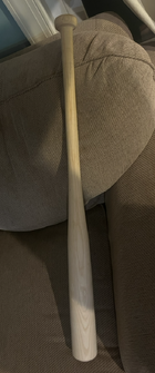

My son is wanting to make his own baseball bats so I am looking for a lathe that would be suitable for doing that. I went to some local woodworking stores and got conflicting information so I thought I would ask here what I would need? I am open to new or used. Thanks

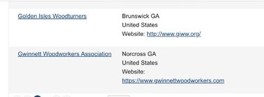

I suggest you Contact the local chapters near you. They often have members who sell used lathes when the get newer ones.
Georgia chapters
