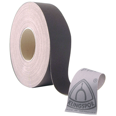

I posted this on another forum and got a couple replies. But, thought I would post it here to see if anyone else had any comments pros or cons on the product.s.
I mainly use Vince's blue discs or Woodturners Wonders discs for power sanding.
But, I do hand sand sometimes. In the past I have used Klingspor's 2"x 10yd j-flex cloth backed "shop rolls" which are the reddish/brown color. The description states "Whether you're a turner, a carver or just need to sand that certain little spot, you'll be raving"
But, Klinspor also sells their Klingspor Gold in rolls 2" x 32ft j-flex cloth backed.. The description states "This material is also used in wood sanding and is often called A Woodturners Dream Paper."
https://www.woodworkingshop.com/product/sr00881/
Both products are aluminum oxide and claim to be j-flex cloth backed.
Opinions based on your own use on which one is better?

I got a box of roll ends of reddish brown abrasives from Klingspor and it was a screaming deal in terms of volume of product for the dollar. However, the cloth backing is so thick and stiff, that they are unusable for hand sanding, in any application in which I've tried them. I was also not impressed with the rate of material removal, though that was hard to evaluate given the difficulties in using the abrasives. YMMV

Dean, I was told once (but I never confirmed it) that the bargain box of roll ends was from heavier duty rolls used on the big thickness drum sanders. The reddish/brown 2" rolls that I have been using from klingspor that I linked above are not that stiff. I have been using them for a couple years. But, saw rhat they carried the same size roll in their gold line and was wondering about the comparison.
