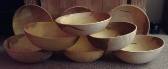

No difference than small bowls, except time. A good coring system saves a lot of that time. I would have turned between centers to flatten the face so the faceplate laid flat.
Here's a stack of 18" finished diameter bowls. I made 24 of these for one patron.
