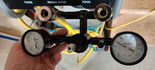

I've captured a few (somewhat potato quality, sorry, was trying to hold the phone and the part at the same time and was a bit shaky) photos of the assembly.
This is the whole thing, regulator in the middle sans its red knob:
The regulator assembly itself:
Manifold, with the regulator assembly removed. There is a membrane, or bladder, inside the manifold here, the green part. This holds pressure to the tank side. It seems to work fine holding pressure on that side, but, I think this is half of the problem when there is pressure on the hose side (I'll explain more on my suspicions in a moment):

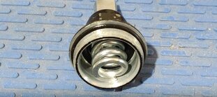

The regulator assembly. This has a metal housing, a threaded screw with a flat part that notches into the red knob (knob not pictured) that pushes a domed metal plate inside. That plate sits at the bottom of a spring (see next picture), which pushes on a plastic assembly with a nozzle and a grooved o-ring (later photos). The nozzle presses into the membrane/bladder to release pressure into the hose side of the manifold. NOTE: There is a hole here, where air escapes when pressure on the hose side is RELEASED (i.e. when you reduce pressure to zero, this is where the air is escaping and where you hear a hiss. THIS is where I am hearing a hiss nearly all the time if I have pressure to the hoses now, which is the main problem):
Continued in next post due to image count restriction!!
The spring inside the assembly (domed plate is at the bottom, which is pushed in or allowed out by the screw that attaches to the knob (which you can see above):

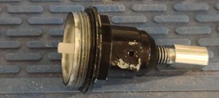

The plastic part, with the grooved o-ring. The nozzle in the middle pushes into the green bladder in the manifold to release pressure. I believe it is the interface between the two, where air is escaping. I did some testing and checking, and I am not hearing any air escape from o-ring areas (there is another o-ring on the housing itself, which you can see in the photo above, and I have noted no escaping air there at all with a soap bubble test):
The same part, flipped upside down. The larger diameter circular part in the middle fits perfectly into the center of the spring that sits inside the housing of the regulator as seen above:
I have analyzed this for some time now (the issue I think started some time ago, but became particularly bad only about a week ago, at which time I disassembled the regulator to clean it). I believe the problem is that air is escaping past the bladder/nozzle interface, through the hole in the center of the nozzle (seen above here), after which it travels through the regulator housing and escapes through the hole in the side of that (which you can see in the first photo of the regulator assembly above.) I've tried to clean the bladder and nozzle tip so they are totally dry, to see if that would resolve the problem, and also tried to put a bit of oil on them to see if that would help seal better. Neither approach seems to be working. I cannot find any damage to the parts, and as I mentioned before if I do not allow any pressure into the hose side of the manifold, then pressure is maintained indefinitely in the tank...so, I don't think there is anything wrong with the bladder which is actually part of the manifold (green colored membrane in one of the photos above).

The entire manifold can be easily replaced... I just haven't been able to find a replacement, nor even a part number (unless its literally part #4...) The manifold assembly is connected to the tank with a hose, and it bolts to a control panel face plate that itself just bolts to the frame of the upper assembly on the tank. So its not a problem to remove the entire manifold assembly. I can remove the gauges from that, if I can find a replacement manifold.
