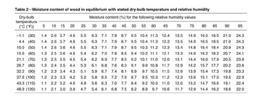

Controlled environment is the key to drying Wood. The table below from the forestry service shows EMC you can achieve in your environment.I keep the drying room humidity at 50% so my wood will dry to around 9%
equilibrium
I noted that several of the replies used the term "stabilized" instead of the more accurate term "equilibrium". I go by "Hoadley's Understanding Wood" which never uses the term stabilized.

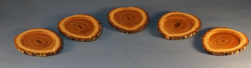

I have been using an obsolete mail scale (obsolete only because the manufacturer stopped making the plug in modules for mail rates) and like Roger detailed I weigh each piece and keep an individual record and reweigh after a day or 2 gradually increasing the time between weighing. The group drying process and the finished reassembled natural edge coasters.
You could do without a moisture meter. I use a moisture meter on every bowl block in the waste corners, and I do so to get an idea of what kind of MC I'm dealing with. This is useful information to know. If my moisture meter conked out, I'd buy another.....

I saw a chart once, not sure where, that stable MC for where I live is 13-14% so I've stuck with it since then.
I'd like to take a look at that chart, Randy......very interesting indeed!
I've always felt that stabilized MC for around here in Montana is around 12%. (I guess each moisture meter might calculate a little differently......so that might introduce some variance.) I've gotten KD wood that metered as little as 6%, but most commonly KD boards are anywhere from about 10% to 14%......probably depends on each individual facility, and the climatic conditions of where they are.....I suppose.
I've always assumed that, eventually, any wood that is less than 12%, will eventually increase until it reaches that mark. That could take some time, I guess.....and, I've never really tested that theory. Anyone here actually run some hands on testing of this theory?
Odie, here's a link to one at the Dept of Agriculture US Forestry Service site. Chart begins on page 6. I think I found a few others with similar data. The "science" of MC, which I know nothing about, gets very complicated and the variables re temp, RH of the environment, etc made my head spin. Seems anything in this world can be reduced to and explained by long math equations. The net for me was that about 13% was a reasonable target for my area. I get lower than 13% on a lot of my pieces by the time I get to finishing them. Max 13% in the thickest parts is when I take them off the shelf and start the next steps.
