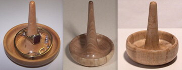

YES TOO LATE AS I SEE, but here is my idea of how to get there.
I've turned some what I call a "ring caddy"
Not drop spindels of course, but pretty similar to what you are wanting to make .
I have one in a Oneway Talon chuck, so to show how, I start turning the piece held in the chuck and steady it with the tailstock center, turn the outside of what will become the cup and a shallow recess in the bottom end, so I can hold the piece with the recess on the chuck, (later I remove some of the wood that made the recess as shown here, but maybe not for what you want.
Flip the piece end for end and start removing the wood for the pillar to hang the rings on, then using a Oneway Termite end-grain ring tool I hollow the cup, it will hold the watch and earrings etc
This is what I need for what I want to make, you can change this of course to what you want to do at this point, drill it or change the pillar shape or length
Good luck.
