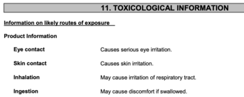

Being water based and odorless is not an indication of safety. It means they use different carriers and solvents. If you are referring to PC's Wood Petrifier, here are the warnings on the SDS document. https://www.pcepoxy.com/wp-content/uploads/2019/07/SDS-Petrifier-Canada-Eng-2018.pdf
