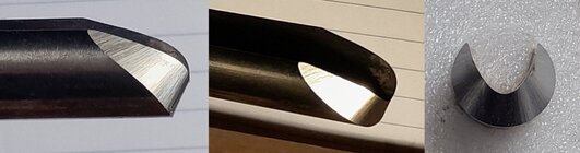

For reference, here are the flute profiles on the Glaser BGs, early version on the left and a later version on the right...
Doug Thompson's V picks up on the style of Glaser's later design and is just a bit more open...
Dave's D-Way Vs have a similar flute profile , but are not quite as open as Doug's...
Despite the description on the D-Way website, which reads, "The flutes are a parabolic U-shaped with tapered sides, not a deep V ", to my eye it is neither parabolic nor U-shaped and every bit a V in the tradition of the later Glaser and Thompson Vs. They have straight upper sides that slope away from each other (so not parallel to each other like a U flute) and do not the continuous curve of a parabola as shown to the right of it above for comparison. This is not a criticism of the D-Way BGs as such, I have and do like them, but just pointing out what I see as some very confusing words to describe its flute profile.

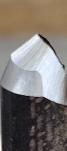

Here is the grind that Carter & Son put on their 5/8" U-fluted 'Bottom feeder" BG with a 60° nose bevel angle...
That grind is similar to the grind on the U-fluted(?) bottom feeder from D-Way...

I have used a slightly similar grind on a large U-fluted gouge that I used for facing off blanks, but with a more acute nose bevel angle...
And, for reference, here is the traditional straight across grind on a U-fluted gouge, with the wing tips eased off a bit...
