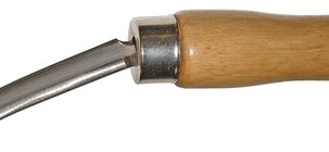

All of my UK made woodturning tools are many decades old and I expect were heat treated in the traditional way with softer steel being left on the tang end. As you say, this is beneficial where the tangs have a small cross-section like they do with traditional style roughing gouges and scrapers... where it is better for the tang to bend than snap off...

It is difficult to tell from your picture but if the tool is a Spindle roughing gouge then these tools can bend if used for tasks other than spindle roughing
I think it was Stuart Batty who stated that Craft Tools were having about 100 roughing gouges returned each year because they had failed
The company to reduce this issue renamed the tool Spindle roughing gouge
