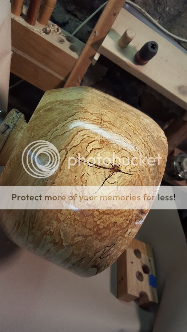

Well done. You survived even with the pith in the middle of your bowl. As a note the appearance of cracks is reduced if you will cut out the pith. The pith shrinks faster than the rest of the log and will result in more likely to lead to cracks . Taking out the pith does reduce bowl size and is a consequence of this procedure.
Spalted Norway Maple crotch
Finish GF 181 pre cat
Cracks filled with CA
This is my very first bowl. I've not turned a hollow form before.

Raul, that is quite a first bowl effort!
I can remember the first time I tried to turn a bowl. It flew across the shop and broke into smithereens! A complete disaster. Very nice work on a beautiful - but demanding - piece of stock.
