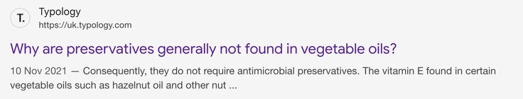

If you use supermarket walnut oil you need to read the label to make sure it has no preservatives in it. I make a wax finish out of walnut oil, carnauba wax and bees wax. It does wear off over time but is easy to reapply with a soft cloth. Just put a healthy coat on the bowl and then buff it off with clean soft cloth. I give a small tin of it with every bowl i sell.
I’ve never heard of preservatives used in cooking oil. Certainly not the stuff we generally use which is cold pressed unfiltered olive oil.
I did look it up though and found this.
It may be different over where you are?

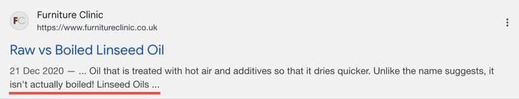

I read many years ago that “Boiled” Linseed Oil isn’t actually boiled as you suggest. The process just makes it look like it’s being boiled.
Right, and actually *I* didn't suggest it is boiled - hence my tendency to put it in quote marks - What I usually mean when talking about "Boiled Linseed Oil" is what is commonly bought off the shelf as "BLO" or Boiled Linseed Oil - This stuff (Miniwax is common US brand) is basically a linseed oil that is thinned (Mineral spirits typically) plus metallic driers and other agents to hasten the curing process (as well as it being applied more thinly)
