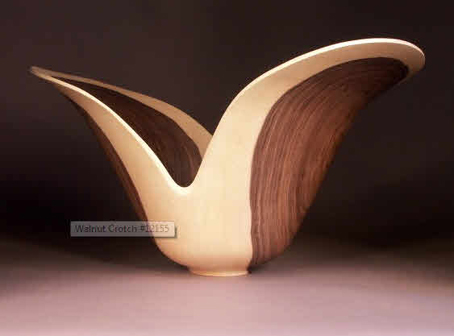

End grain produces wings that follow the the curve of the tree.
The wings can be really long.
So you need to start with a crotch that has nice looking curves on the two leaders,
These bowl can be dramatic and sculptural an usually Very tipsy.
I personally much prefer the face grain crotch bowls which are useable like the bowl below.
