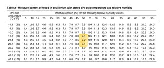

You can easily determine how dry your wood will get in each location with a thermometer and hydrometer.
Simple wood science the wood MC(moisture content) will reach equilibrium with its environment.
My drying room had a dehumidifier that keeps the humidity at 50% - highlighted area in chart
My pieces will dry to about 9%. They will never get any dryer in that environment
This is a US Forestry service chart
I use a two pin moisture meter on the tenons. When it is around 9% I consider the bowl dry. Not super accurate since it doesn’t measure the bowl walls - it works for me and isn’t much work.
A more accurate method is to weigh the bowls periodically (once a month or every 2 weeks). When they stop loosing weight they have reached equilibrium in that environment - assuming the environment has not changed.
