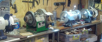

This is an older picture of the whole sharpening area, now missing the bench grinder on the far end that I gave to a student.
One day when I'm bored I'll prob add a second Tormek, currently gathering dust on the floor.
