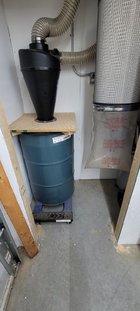

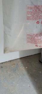

I have seen a few people on YouTube say it is not worth getting a cyclone to add to your dust collection. In my opinion it is well worth it. It was so much easier to get my 3 inch rubber palm sander when it got sucked in the back of the lathe a couple of times. My 55 gallon barrel is half full and the bag on the dust collector bag has less than a cup of dust in it. Very happy I went this route.
Rusty, your cyclone is designed correctly. I can see that they made a considerable effort to handle the airflow correctly. Those who say a cyclone is not worth it, has not experienced one that is correctly made and installed. I designed mine to take into consideration aerodynamics. Almost nothing makes it to the filter.
...the bag on the dust collector bag has less than a cup of dust in it. Very happy I went this route.
I also only have had a half cup of dust that ended up below my filters after 15 years and countless (in the hundreds) garbage bags full of shavings and dust separated by the cyclone.
I also run a fine dust particle counter whenever I'm in the workshop and I know without the slightest doubt from its readings that my cyclone setup is highly efficient and no fine dust is escaping it.
Those that post on YouTube are a mixed bunch and anything seen there should be viewed with caution. My first question whenever there are claims on YouTube on DE performace is can you show me your particle counter readings to support your claims/assertions.
Note: My cyclone has a full size 3:1 cone ratio and 6" ducting (per Bill Pentz' specs).
