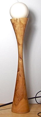

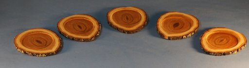

I have to assume that you are referring to juniper which is sold as red cedar or aromatic cedar. The cutting of juniper into cookies may or may not work as it could develop radial cracks. The method I have used is to cut the cookies on the band saw then saw thru the pith and dry, then when dry true up the cut edges and glue back together. The first pic is a keepsake Urn turned from the full round (with the pith) and the second is coasters made from northern red oak limb wood and you can see by the oval shaped center that they were made using the method I described.

Thanks Don, I really appreciate the advice, have a Rikon 18" saw and new blades coming, will research to make a sled for accurate slices. Have found a jig I like on the forum for bowls. My present blade wobbles because I freehanded things I should not have.
The urn is stunning, would love to start making something that beautiful but that is a skill set and set of tools that I do not have, at least the hollowing. I will do some as you suggest, then slice the same number whole and store them for curing to get a percentage of success of different methods. The coasters are exactly what I want, they look great!

Here is some cookies I cut in in November (note there were 3 layers in the record) where you can see the value of cutting through the pith.

So you put the cookies in something to slow dry without putting a coating on them? I ran across some 1/4" polycarbonate sheets and cut my wife some cake sheets and she has not started using them. I could probably get away with stacking layers of cookies on these inside a garbage bag, should help keep them flat. Have about 10 of them, that would about fill up a trash bag...
The cookies were cut and placed on wafer board without any coating or covering just like you see them in the picture.
