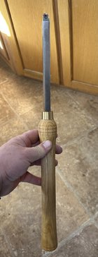

I can turn outboard on my Nova DVR XP so my mind was wandering last night. My subconscious just doesn’t want to give up this idea of coring. The tool rest for outboard turning is quite stout and could be used to mount a captured very long handled shop made chisel to do the coring. It would only need to be able to advance in a straight line so capturing it would not be too difficult.
I have multiple metal lathe inserts, some of which are already pointed, that could be mounted (brazed?) on a long metal bar for this purpose:
I’ve seen how the Oneway coring tips are shaped and would be able to use one of these metal lathe tips to create a similar shape. I’ve already used one to make a bedan style lathe chisel.
And I’ve made a cupped carbide tool from scratch similar to a Hunter Hercules #4 using 1/2” square metal stock. I turned the handle from a piece of ash firewood:
I’m no metal worker but I love to tinker and “invent.” Mainly just for the challenge of designing, building and successfully using it, without hurting myself or breaking things in the process lol!
How thick, wide and long a piece of stock mild steel would be needed for this kind of wood coring?
So … talk my unruly brain out of thinking about this further if I’m just going to hurt myself or break things!
The dimensions of the tool will depend on how much edge engages the wood, at what angle, at what speed, and how far from support.
Wild donkey guess, 1/8" of thickness per inch of overhang, with the amount of edge decreasing as you go deeper. Probably no more than 3/32" of edge past 4" of overhang (another wild donkey guess), assuming it is sharp. The edge, whether scraper style or cutting style, should be moving from center outward to avoid driving into endgrain. To accomplish that, to me it means you drill a hold to ultimate depth, so you have a space to start your cut or scrape. A hook tool or Hunter tool can have the cutting edge oriented to cut across the end grain fibers. A hollowing tool would typically be a small scraper, and your metal bits mounted on a boring bar could be such a tool. Lastly, you can move the tool rest toward the bottom of the cylinder and shorten the overhang with a special "box tool rest". I forget who makes them.
Ultimately, you're choosing to make this task harder than it needs to be, and that's your prerogative. Be such to wear your kevlar nose guard and catcher's cup. ;)
