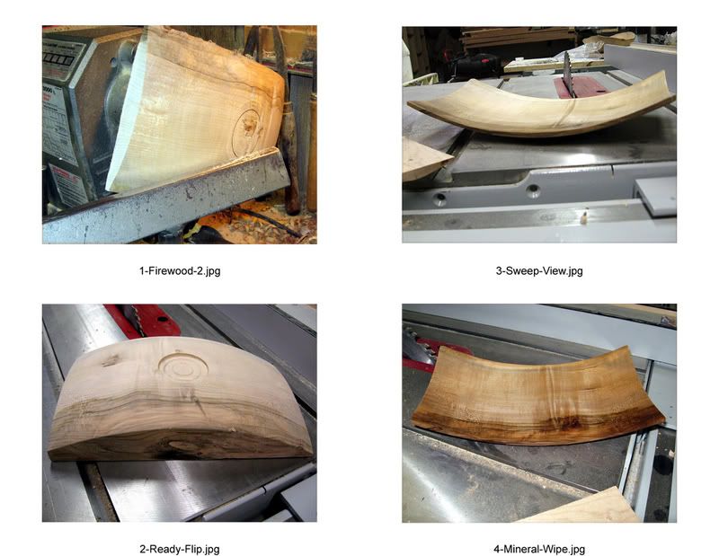

Shame on you. That bandsaw is the key to maintaining your lathe's bearings and your good looks. Trend air shields are not going to stop a lump spinning off at 3K, so you should take care of it yourself. No sense beating the lathe to death by not rounding and even trimming your basic block before mounting. What you don't need should be gone, especially if it interferes with good balance. This works, http://i35.photobucket.com/albums/d160/GoodOnesGone/Bark-up.jpg but it would be better to do this http://i35.photobucket.com/albums/d160/GoodOnesGone/Biggest-Ever.jpg and have some of that unneeded wood out of the way. That much weight differential that far out is tough on the lathe, and if you, for reasons unknown choose to use your spur center instead of other safer options, could be tough on you if you dismount. Some of us don't think it's any great achievement to mount a badly out-of-balance piece on our heavily weighted lathe and beat ourselves and the bearings to death. We use our bandsaw instead. http://i35.photobucket.com/albums/d160/GoodOnesGone/Trim-for-balance-1.jpg
NO WAY would I turn at 3K, 680 is fine for the likes of me. It's also the max recommended by my chuck manufacturer, oddly enough. I remember those red lines on the side of propeller aircraft. The ones that said "propeller disintegration zone". So slow is good enough if you cut the wood. http://i35.photobucket.com/albums/d160/GoodOnesGone/ContactSheet-Fire2.jpg Not even too bad a surface "from the gouge" if you look at 1341 and 1344 here. http://i35.photobucket.com/albums/d160/GoodOnesGone/HeartBirch.jpg

i probably should shape my blanks a little better, your point on savings your bearings is a good one
http://i35.photobucket.com/albums/d1...ne/Bark-up.jpg
i also like to use my tailstock pulled up as much as possible
i see you are still using your roughing gouge on bowls, your tool control has to be exact, that scares me as much as my bandsaw, those are very nice bowls, cherry??

This is one of the advantages of NOT buying your last lathe first. It forces you to form good habits, such as balancing the lump before serious turning. And the bandsaw cuts don't have to perfectly round; initial turning cuts will have some thump, thump, thump anyway, so 8 or 16 sides by bandsaw or chain saw can be adequate. The waste pieces are easier to dispose of, versus copious shavings, or they can be saved foe smaller future elements.
If the workpiece is still unbalanced, best found by letting it drift on the lathe, I reduce it further with a Lancelot in a right-angle grinder. To reduce motion, I use a couple wedges between the workpiece and the lathe bed. This is a little better than using the lathe's locking devices, because it's applied directly at the point of need.
