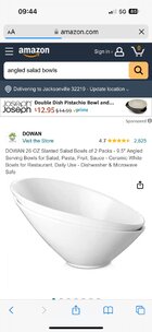

Have a beautiful piece of camphor on my lathe. Would like to create a "angled bowl" as finished product - that is - bowl sits flat like normal but rim is angles so can see inside of bowl without peering down into it. Picts of current status and desired final shape attached.
Have thought of:
1. Cutting foot at angle then using glue block at opposite angle so can still turn round.
2. Cutting rim at angle before turning inside - doubt this will work due to inherent wobble cause of weight differences
3. Doing same as 1 but at rim/top then knocking off angled piece after turning. Have discounted this one as well due to concerns about breaking rim when try to part the two pieces and potential of joint breaking during turning.
4. Making bowl as normally would, then cutting rim at angle - most likely by making line for cut then using dremel. Considered bandsaw but concerned about safety and blowing up nearly finished bowl
Any thoughts greatly appreciated.

I think your 4th method is the way to go. The 1st would give you balance issues. The 2nd would be okay, but the turning would be more challenging.
I suspect the bandsaw would be safe enough if you made a sled and used something like hot melt glue to keep the bowl stable. Dremel method would work well. Pro-tip, if you need a straight line, dunk the bowl, rim-side-down into some sort of liquid and then cut along the line. Or use some other guide. Clean-up the rim edge with a sanding disc or a piece of sandpaper attached to a flat surface. Most importantly, post a photo your final bowl to the gallery šŸ˜Š

Thanks everyone. Pictures in current form attached. Just off the lathe and ready for sanding.
I have decided to forgo the angling of the bowl. First - to my eye it looks a little too short and I am concerned about the final appearance with the angle. I might end up building a stand that will allow it to be displayed at an angle. Second - the boss said she loved it just the way it is and since this is an anniversary gift I figured I had better listen šŸ˜Š
