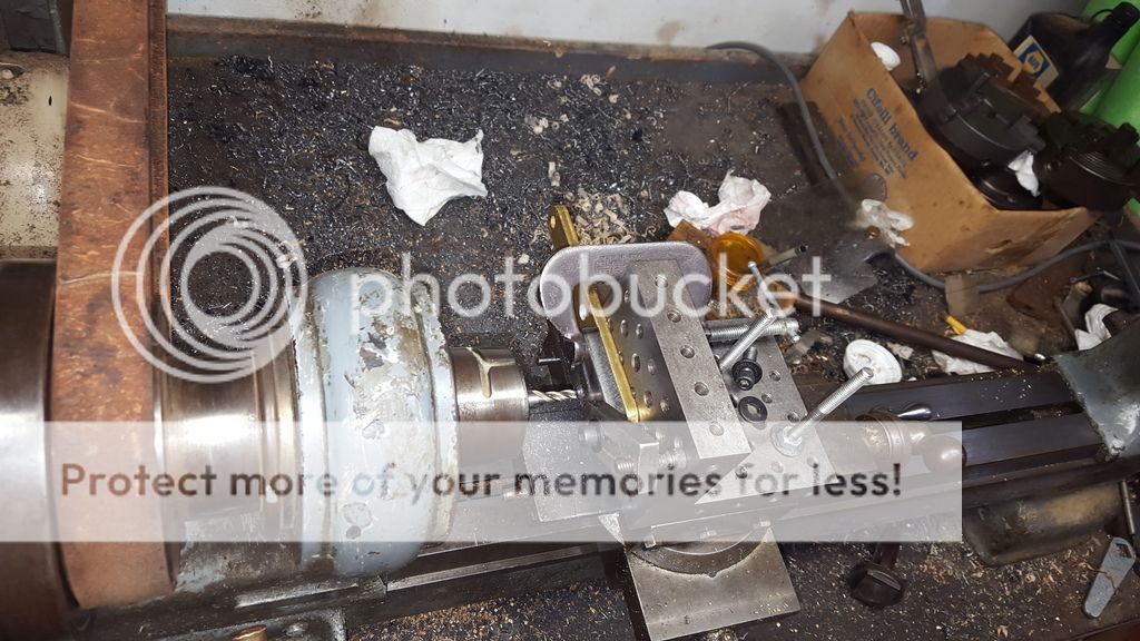

I’d have posted this last week, but because I’m a dummy, I snapped my only M3.5x0.6 roll form tap by mis-reading a chart and drilling undersize and my replacement tap was back ordered so I couldn’t mount the carbide insert. I almost never work metrics and have no developed memory and instinct for tap sizes like I do with inch standard so I should have been more careful but - - well - - that’s me. Always in a rush. Removing snapped taps is always a PITA.
http://i1002.photobucket.com/albums...culated Hollower/Hollower-002_zps9uolwbhf.jpg
My "milling machine" is an ancient Elgin Jeweler's lathe Between that an old Walker Turner Drill Press and a some hand held tools I got 'r dun.
http://i1002.photobucket.com/albums...ated Hollower/20151021_103829_zpsolxvrtuv.jpg

I like your shield, but are you using it with a square cutter? Also you might want to try a Rolly Munro cutter with your shielded tool becazuse it has a raised rim similar to the Hunter tools which make it a true cutter and not a scraper.

The carbide insert is round with ha turned up edge to get a cut and not a scrape It's a Kennametal RPHT-EN style cutter. Don't know if it's Kennametal brand.

Comparing your shielded hollowing cutter to the Munro design, I think that you might be able to get the shavings to exit the hole a little smoothly if you use a grinding stone to remove some material at the back edge of the exit hole -- in other words make the hole angle backwards if that makes any sense. Perhaps you have already done that, but just looking at the pictures it appears that the hole is mostly vertical.

The chip clearance exit hole is in at a 25 Degree angle. I considered rasping it out more in the back end, but when I tried it, I liked it and decided It was good.
