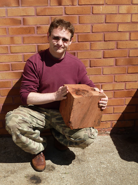

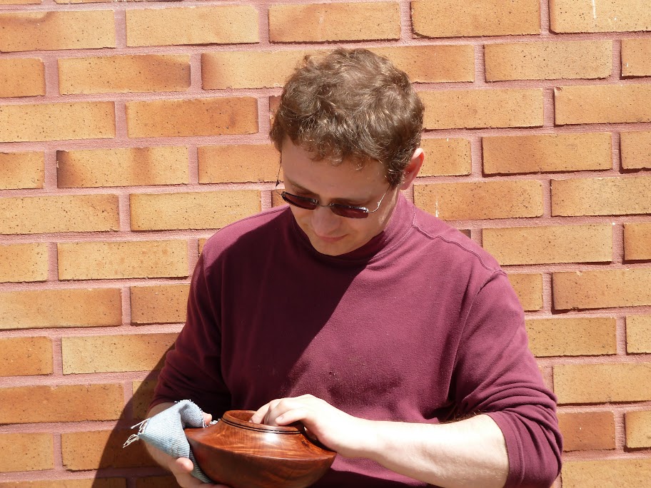

I've used linseed oil on this California redwood burl. The wood did get darker but not too much.
BTW In any case before applying finish I recommend you to put some "Zinsser SealCoat" sanding sealer on your bowl and sand some more. Redwood is somewhat prone to tear out.
If you had a chance to compare two redwood bowls one with some sealant treatment and one without you would definitely see a big difference.
Original color of the piece:
http://lh3.ggpht.com/_gzA6aeqk3VE/TI-YmgpJUvI/AAAAAAAABx0/fX1ujuMdxWE/s640/P1010933.JPG
http://lh5.ggpht.com/_gzA6aeqk3VE/TI-Yz9SqUmI/AAAAAAAABx0/6aZ8otT4jpQ/s912/P1010942.JPG
