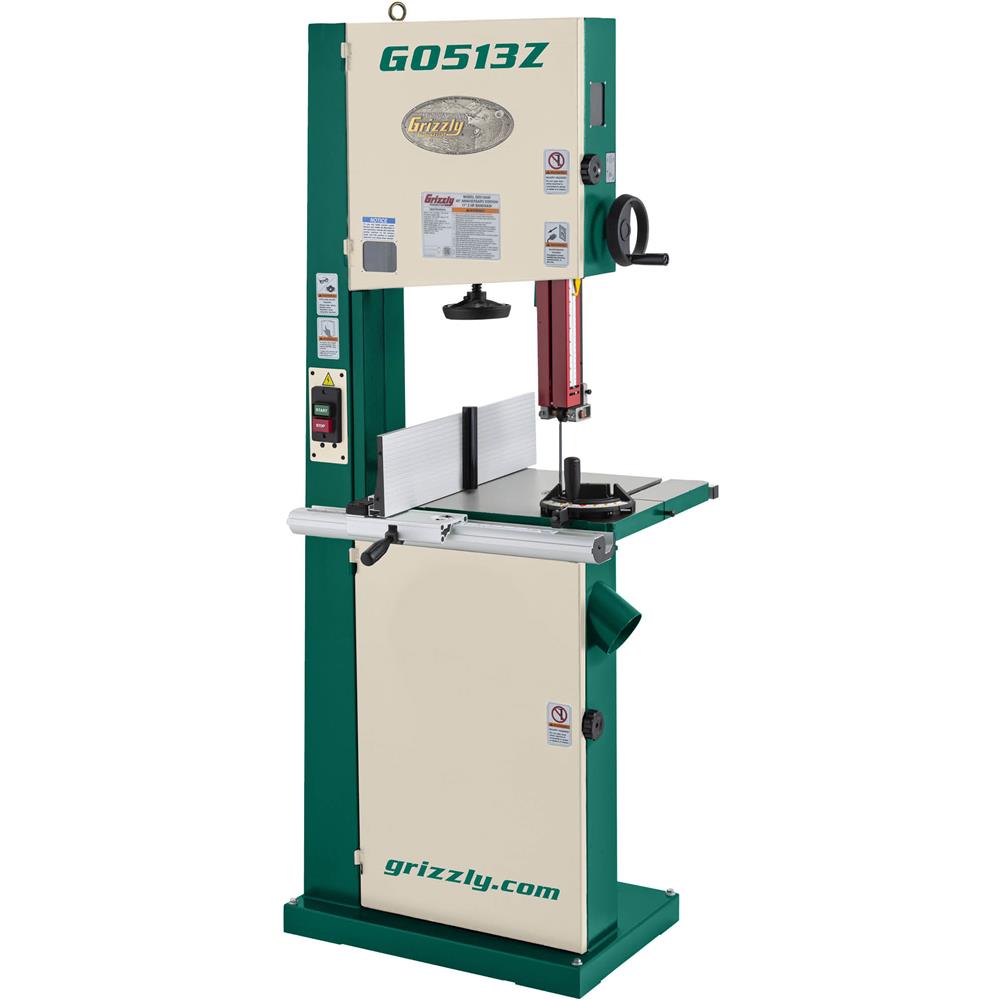

Have had this guy for about 2yrs ... love it. From resaw, to veneer, to cookies, to large circles and smaller intricate work has performed flawlessly. Blades change easily, really like the
brake that stops the blade within a sec. Grizzly has it on sale from what I paid by $200 right now. Shipping/packaging was great. Has a big eye hook at the top of the machine to hoist onto a mobile base.
