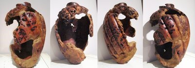

For me there nothing better than turning this sort of blank, every day all day long, and I guess half of it is the challenge. Ok, I realise it's not for every one. But would you have put this one in the firewood box? Sometimes I think we pass an opportunity by without consideration of what could be. This was the ugliest piece on the shelf, and it sat there drying out for a couple of years. I turned the outside, held it by the foot with the steady on the rim and turned the inside at around 500rpm, at a guess about 50% is missing. The Mistletoe as we call it, is a parasite that grows on the eucalyptus trees, in this the connection was a small branch about 50mm in dia that ran through just above the rim or opening, it couldn't be saved.
I have posted this before, but without the full wrap around shots. Stands about 27cm tall with a dia of 16cm, oiled and sanded very carefully.

This makes me wonder if your mistletoe is a slightly different species than ours. Seems like all it grows on here is the oak trees. Never had a chance to get my hands on some mistletoe wood....
I agree with Mark. If you have any pictures of the blank before turning, I'd sure like to see them.
Thanks Hughie! Guess they are all related, and some like one wood, and others like another.

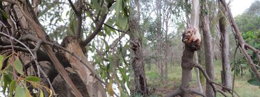

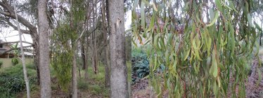

I have a wooded area cross the road from me , mainly all Eucalyptus with some Melaleuca and most of the Eucalyptus have this Mistletoe. Will get a few images when the rain stops, be interested to hear your thoughts if It's like the North American species.
