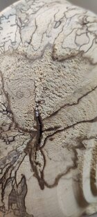

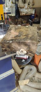

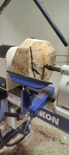

I have been tripping over this piece of sugarberry for a year. I decided to turn it, knowing some of it might be punky. First step, get it trued up.
Lots of tearout in the pith.

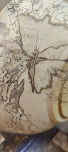

I soaked it with a 1# cut of shellac, sharpened my gouge, and tried to get rid of the tearout. It worked as well as I could have hoped. I had to do this twice, because I broke the rim and had to reduce the overall size to fix it.

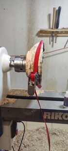

Unfortunately, when I turned the inside, a big crack developed from the pith to the rim. Not surprising. So I glued it up and applied the Hillbilly Web Clamp.
I took the tie-down strap off today and it looks pretty good. However, getting this bowl true after the gluing is going to be dicey. I think it'll just blow apart. I'll tinker with it today and see if I can save it.

I'll be right over here in the corner with the popcorn. Did you resist the urge to turn it on with that strap still on it just to see what it would do?
I thought about that for about 250 milliseconds, but dismissed the thought immediately due to the weight of the ratchet. I also thought about putting a big rubber band around it when I go to finish the inside. It was flexing pretty dramatically.

If you really can't resist risking it... try strapping tape - that's the packing tape with strings in it.

Wonder where they get those big rubber bands that are used on ceramic molds? They seem pretty massive. Or maybe a lawnmower tire tube with the inside cut out so it would "cup" the bowl?

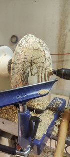

I think it will live. When that crack formed, it threw everything out of whack. I wasn't aware of it for the first few seconds. Continuing to turn with that crack and all the flexing left a lot of tearout and unevenness with the interior walls. I cleaned it up the best I could. I was tempted to use a scraper to smooth things up a bit more, but experience has taught me that on woods like this, it just makes things worse. So, I have some sanding ahead.

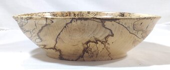

Wally, I mix my own shellac to a 1# cut. That's a pound of shellac flakes for a gallon of alcohol. I only mix a pint at a time, though (2 oz. shellac for a pint). The advantage to this thin cut is A) it's thin as water so it soaks in well and B) it dries quickly. I just brush on a single coat of shellac for the most part, but on the really punk stuff, I pretty well soak it.
You could immerse the blank, but I don't think there is any advantage over a liberal application of a 1# cut shellac.

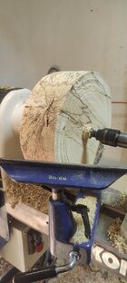

It's been too hot to turn this week, so the bowl is sitting there chucked up on the lathe just as it was in my last photo. I hope to get back to it by Friday.
