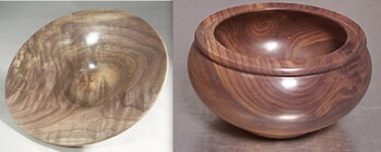

Black Walnut grows with a light color sapwood that will turn into a darker color by leaching and light influence.
The leaching starts almost right away when the tree is cut, but you can save that light color if you cut it off the log, and you then need to dry the wood quickly. (without splitting)
This is one with just a sliver of dark wood, the light color becomes more of a darker color, it does change over time like all wood does.
I have done just a couple, but the light sapwood is nothing to write home about, the dark color is much nicer IMO.
The sapwood turns like the heart wood, it is equal to the darker heartwood I that regard, I never noticed a difference in turning it.
The loggers that sell black Walnut do not like the light sapwood, they want to sell the dark Walnut, so they steam the wood and the sapwood will turn dark like the rest of the log, taking some of the color from the log and the log will loose the color variances that it had before.
Here is one haul of 4 I got of Black Walnut logs, I was allowed to take all the wood I wanted, it was out of a recent cut gulley of veneer quality logs the owner had sold, what I did not take became firewood.
You can see the sapwood, and the amount does not change as the tree gets larger, so a very large tree has little sapwood in comparison to a small tree.
At the border of light to dark wood you can find different colors, of course not in steamed or ponded wood, where it all becomes similar brown or close to the same.
So I rather see the natural coloration of the Walnut wood, though all of that does get less as time goes by, but still stays nicer than the muddy brown of the steamed wood imo.
1,123
1,685
Fresh cut walnut is green until it oxidizes. It's one of the rare woods that gets lighter with years of aging. I would not call the color as brown.
I have cut enough Black Walnut fresh, and it never was green (color) certainly closer to brown, and yes the dark heartwood will get lighter.
here is a fresh cut log, less than 2 hrs from cutting them up, as carrying the logs out of that steep gulley was pretty hard to do, so cutting them smaller did help.
This bowl in the picture below sat for a long time in our hall, that is facing north, which is light but without direct sun shining in, it did get quite a bit lighter in the 20 years or so.
And no I have no picture from when it was new, so no comparing from new to older.
