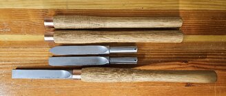

These Carter fellas make a darn serious M42 tool, huh? Three new 1" x 3/8" scrapers epoxy mounted into oiled white ash handles with polished copper ferrules. I swear, this better not become a slippery slope!

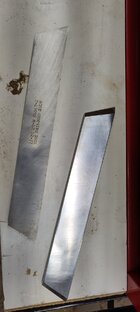

M42 5/16" x 1-5/16" x 9" I double sided mine.

Acme grooving tool? What was it's intended purpose? It doesn't look like it was a hand-held turning tool to begin with.
I assume it's first job was possibly ship axles or drive shafts. I adapted the idea from Ashley Harwood. I realized I never put the handles on my Stuart batty scrapers, so I ditched the handle for my experiment. NRS works perfectly on the outside since I am 1/4" off the toolrest when finishing the outside, it's not a problem.
